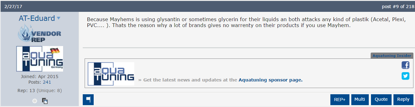

Not suitable for continuous operation with liquids containing Titanium Dioxide or Glycerol.
Typically, many pastel colors use these additions, like Mayhems Pastel fluids.
Using these fluids will void the warranty!
Removing the impeller from the ceramic axis results in an overstretch of the upper clamping ring and thus its destruction!
If the pump is reassembled and used, the pump will lose its power, this is not covered by the warranty.

CLAIMS (AND THREATS) FROM ALPHACOOL / AQUA TUNING
  • Here, here, here (screenshot, screenshot, screenshot)
    • they claimed that fluids from Mayhems are harmful and void warranty of "a lot of brands" (including EKWB, Watercool, Aquacomputer and others)
    • they refused warranty claiming that customers removed the impeller (the above reports contradict this hypothesis)
  • Here: customer reported his warranty was refused because they used Mayhem biocide.
  • Here and here: customer reported threats from Alphacool after posting an email showing Alphacool refusing warranty, and photos made by Alphacool (I witnessed said post).
  • Here: 3 failed pumps due to noise, Alphacool asked customer to not post publicly about it.
  • Here and here: refused warranty/repair claiming the customer used pastel fluid and that they found sand in the pump (???)
  • Their online shop (here, screenshot) claims that using Mayhems fluids voids warranty of many brands.
  • Here: they changed the conditions for warranty, now claiming that all pastel coolants void warranty. This was not a warranty condition included with the shipped product. I and others can confirm that, see here.
  • Hereand here: A Skype conversation between Eddy (Alphacool / Aqua Tuning PR rep) and Mayhems, after Mayhems confronted them about said claims regarding Mayhems fluids, shows Eddy confirming that he is "not a chemist and that [he] did not check if something is correct or not" (!!!!)
  • As confirmed by reviews here and here, they initially claimed the pump is compatible with all D5 tops, then changed that claim to all "current" D5 tops. However, the said reviews showed that it leaks with some current D5 tops or is incompatible with some current D5 tops.
    • I confronted them about this here but received no response.
As of March 1 they stopped replying in this thread or on PM, despite initially asking me to PM them.
RESPONSE FROM THE OTHER BRANDS TO ABOVE CLAIMS
  • Mayhems responded here and here, strongly refuting the above claims, and ceasing to supply Alphacool / Aqua Tuning with Mayhems fluids. Indeed, most watercooling enthusiasts, myself included and others in this very thread, can confirm that Mayhems coolants are among the best and have not damaged any parts (NB: All EKWB coolants, clear and pastel, have been made by Mayhems, confirmed here). Note that the Aurora product from Mayhems is different and excluded, and Mayhems has always been crystal clear about it being meant for photo display only, and not for normal cooling use! The users in this thread who were refused warranty for using Mayhems fluids did not use Aurora.
  • Watercool responded here, also refuting the above claims from Alphacool / Aqua Tuning.
  • EKWB responded here also refuting the above claims from Alphacool / Aqua Tuning.
  • Aquacomputer also responded here and here, but their reply is not very clear with regards to the above claims.
  • Mayhems responded again here, refuting further claims from Alphacool / Aqua Tuning, and showing proof of conversation with PR rep from Alphacool / Aqua Tuning, where the latter confirmed they are not a chemist and did not check if their claims regarding damaging fluids are correct or not!
    • Mayhems also highlighted US and European laws that make it problematic for Alphacool / Aqua Tuning to refuse warranty.
